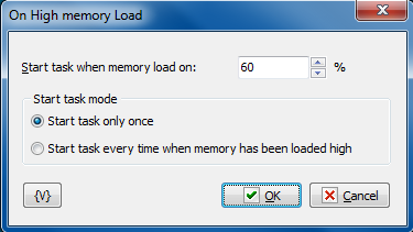

This trigger starts the task when the RAM loading is exceeded the specified value. For example, to send a message or write a warning into a log-file.
Start task when memory load on
Specify a boundary value in percents. If the RAM loading exceeds this value, the trigger will start the task.
Start task mode
•Start task only once. This option starts the task only once at the moment when the value is exceeded. If the memory loading falls below the value, the trigger will start the task again when the value is exceeded the next time.
•Start task every time when memory has been loaded high. In this mode the trigger will start the task approximately once a minute while the memory loading is higher than the specified value.
