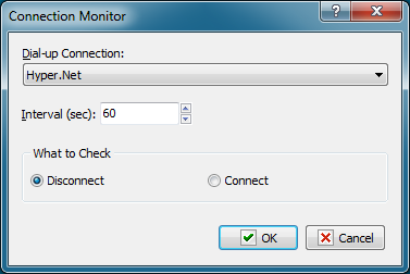

Executes a task when the computer completes or terminates a specific dial-up connection. You can specify that RoboTask check for a connection at a specific interval; for example, you can specify that RoboTask check for a dial-up connection every 300 seconds, or every five minutes.
Dial-up Connection
Select a connection in the dropdown list. The items on the list are the names of the Internet connections for dial-up modems that you create in Windows with Network Connections in the Control Panel.
Interval (sec)
Enter the number of seconds that you want the task to wait between checks.
What to Check
Click one of the following options to tell the task to check if the connection is active or disconnected:
•Disconnect
•Connect
