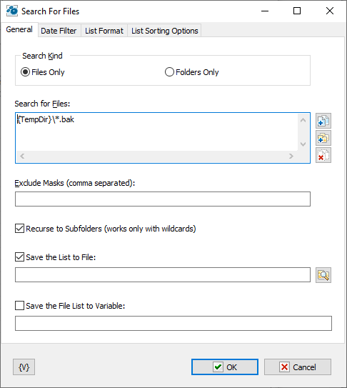

General tab
FilesSearch1
Search for Files
Enter the file path with file mask that you want to search for. Use the Plus buttons to add files or folders to the list. To clear the list, click the X button.
Tip
You can also use wildcards in this option. Some examples of wildcards are the following:
C:\Text Files\*.txt - all the files with the .txt extension in the C:\Text Files folder.
C:\Doc Files\mydoc?.doc - mydoc1.doc, mydoc2.doc, mydocA.doc, and so forth.
{bakext} - file mask(s) from the {bakext} variable.
Exclude Masks (Comma Separated)
List masks that need to be excluded from the search separated by commas. If you are using the search mode with nested folders, you can exclude individual folders from the search. To do this, specify the mask along with the path.
For example:
 C:\incoming\files*.*
This means that all files starting from the folder "c:\incoming\files" will be excluded from the search.
Tip
*.txt - all the files with the .txt extension.
*.tmp, *.$$$, *.bak - all the files with the .tmp, .$$$ and .bak extensions.
Recurse to Subfolders
Searches the files in the subfolders of the specified folder.
Save File List To
Enter a path and name for a file that contains a list of the files that were searched. Click the List Format tab to set other options for this list.

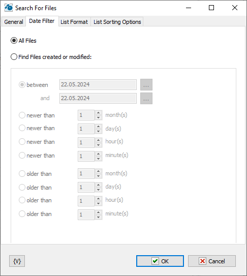

Date Filter tab
FilesSearch2
All Files
Select this option to search all files.
Find Files Created or Modified
Click this option to search files according to one of the following criteria:
Between
Newer Than ___ Months
Newer Than ___ Days
Older Than ___ Months
Older Than ___ Days

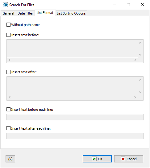

List Format tab
FilesSearch3
Without Path Name
Lists files without the path names (i.e. file names only).
Insert Text Before
You can specify a text that will be inserted at the beginning of the list file.
Insert Text After
You can specify a text that will be inserted at the end of the list file.
Insert Text Before Each Line
You can specify a text that will be inserted at the beginning of each line.
Insert Text After Each Line
You can specify a text that will be inserted at the end of each line.

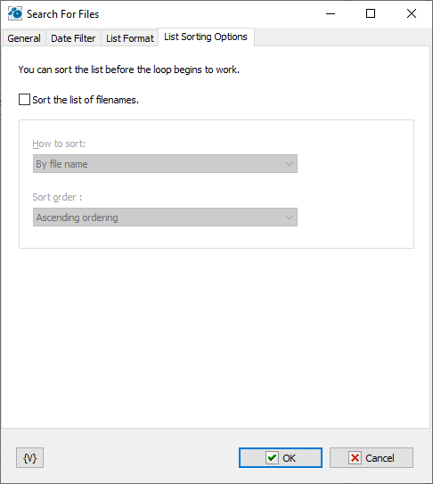

List Sorting options
FilesSearch4
Parameters of internal sorting of the file list
Sort the list of filenames
Turn on the checkbox if you want to sort the list
How to sort
There are four sorting modes:
By file name
By file time
By file size
By depth of nested folders
Sort order
There are two modes: ascending or descending ordering
