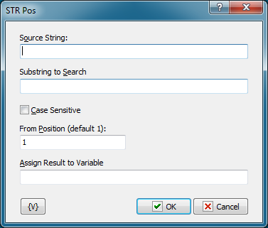

The action determines the position of the found substring in the source string. If the substring is found, the result will be positive. Otherwise, the result is 0.
Source String
The source string to find the substring in. It is possible to use variables.
Substring to Search
The substring to search for. It is possible to use variables.
From Position
The position to start searching from. Position 1 corresponds to the beginning of the string. It is possible to use variables.
Assign Result to Variable
The name of the variable the result of the action will be assigned to. The result is an integer. If the substring is found, the value is greater than 0. Otherwise, it is 0. It is impossible to use macros with variables.
