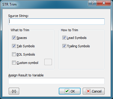

This action allows you to trim unnecessary characters at the beginning and at the end of the string.
Source String
The source string to perform the action in. It is possible to use variables.
What to Trim
The characters to trim.
•Spaces
•Tabs
•EOL symbols – end-of-line characters
•Custom symbol - you may specify any symbol
You can select the options independently of each other. It is enough to select at least one option.
How to Trim
2 options are possible:
| • | Lead Symbols |
| • | Trailing Symbols |
Assign Result to Variable
The name of the variable the result of the action will be assigned to. It is impossible to use macros with variables
