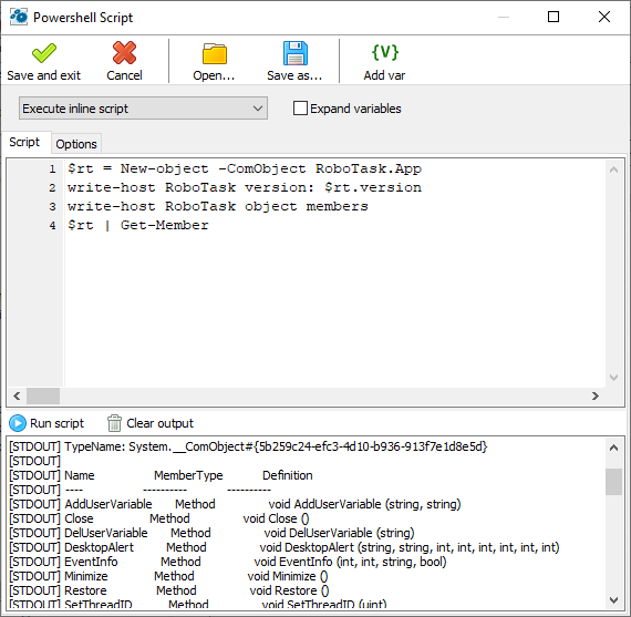

You can use the built-in RoboTaskApp COM object to communicate with RoboTask. For example:
$rt = New-object -ComObject RoboTask.App
write-host RoboTask version: $rt.version
write-host RoboTask object members
$rt | Get-Member
For a PowerShell script, the current ThreadId of the task is passed through the ROBOTASK_SCRIPT_ID environment variable.
Example of the script:
#write-host $env:ROBOTASK_SCRIPT_ID
$rt.SetThreadId($env:ROBOTASK_SCRIPT_ID)
$rt.WriteToLog(0,"Hello",0)

Script Mode
There are two options
•Execute inline script - execute the script you have written in the script editor. In this case, you will see the text editor.
•Execute external script - run the script from an external file.
Expand variables
Check this box if you want to expand RoboTask variables in the script body before running the script. With variables, you can create dynamic text depending on different conditions.
Script
In "Execute inline script" mode, it is a script text editor.
In "Execute External script" mode, it is a field to enter the file name and a file selection button.

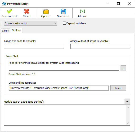

Options
Assign exit code to a variable
Enter the variable name to save the script exit code. By default, the exit code is 0, but it can be changed in the script.
Assign script output to a variable
Enter a variable name in this field to write the script's output text stream to a variable. You will then be able to process this text in your task.
PowerShell
Path to PowerShell - empty by default. This means tan you use system default PowerShell utility. But you can use alternate PowerShell and specify path to it. (for example PWSH.EXE)
Command line template
A command line template is needed to be able to pass custom parameters to the script. The template must contain two mandatory predefined parameters:
•[InterpreterPath] - path to the interpreter module to be executed
•[ScriptPath] - path to the script file
Both parameters are formed automatically.
Module search paths
Here you can set the search paths to additional cmdlets, script files, or operable program.
