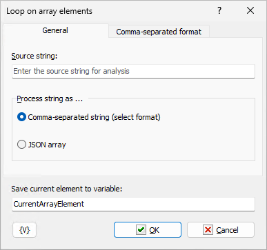

This action allows you to list the elements of an array in a loop. Like the “Count array elements” action, it works with two types of arrays:
Comma-separated string
JSON array
LoopOnArray1
Source string
The string in which to count the number of elements. Available formats:
Standard comma-separated string
JSON array
Process string as...
Specify the processing mode for the source string.
Save current element to variable
Enter the variable name in which to store current element value.

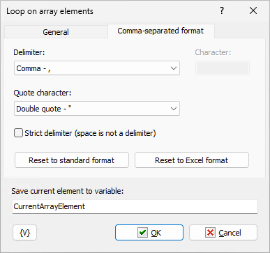

If you have selected the Comma-separated string array type, you need to specify the string format:
Delimiter
Quote char
Strict delimiter
Please note that if you do not use the Strict Delimiter mode, the action will also consider spaces outside quotation marks as delimiters.
The default format is used:
Delimiter = Comma (,)
Quote char = Double quotation mark (")
Strict delimiter = FALSE
The loop assigns the value of the element to the variable at each iteration of the loop.
