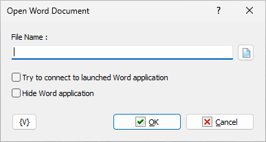

Starts Word and opens the specified document for further work. Operations with the document should be started with this action. The document should be opened first. When the task is completed, the document is closed automatically. If you need to close the document before the task is completed, use the Close Word document action.
File name
The file name of the document is DOC or DOCX. Use the full file name with the full path.
Try to connect Word application
If the Word application is already running, the action will attempt to connect to it. Otherwise, the action will start a new instance of the application.
Enable this check-box if you want to use an already running application.
Hide Word application
Turn on this check-box if you want Word actions to work in hidden mode.
