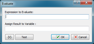

Allows you to make calculations using the functions of mathematical operations and BASIC functions. The result is assigned to a user variable.
This action is convenient when you need to make some small calculations without writing a Basic script.
Expression to Evaluate
Mathematical expression. The result can be of any type. For more details on expression syntax see description of BASIC language.
For example:
{TotalSize}/{FileCount}
Left(Right("{DateTime}",8),2)
Assign Result to Variable
Specify the variable the result should be assigned to.
Test
Click this button to ensure that the parameters for the current action work.
