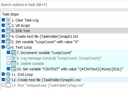

The task came pre-installed in the "Complex" folder, it's name was "Retrieve task parameters to CSV" or "[DEMO] Retrieve task parameters to CSV"

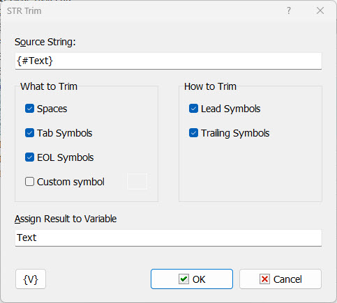

It reads the task names, etc using VBScript into a variable Text. The next statement was Str Trim with the source string {#Text} and the Assigned Results was Text (no curly braces)
RoboTask Code.jpg (80.9 KiB) Viewed 59243 times

I have (for example) many tasks with names that contain strings such as {Date}, {DateTime}, {TaskFolder}, and other variables. I need the original task names to be preserved in the list, i.e., the variables should remain unexpanded.
So I use the explession {#Text}
