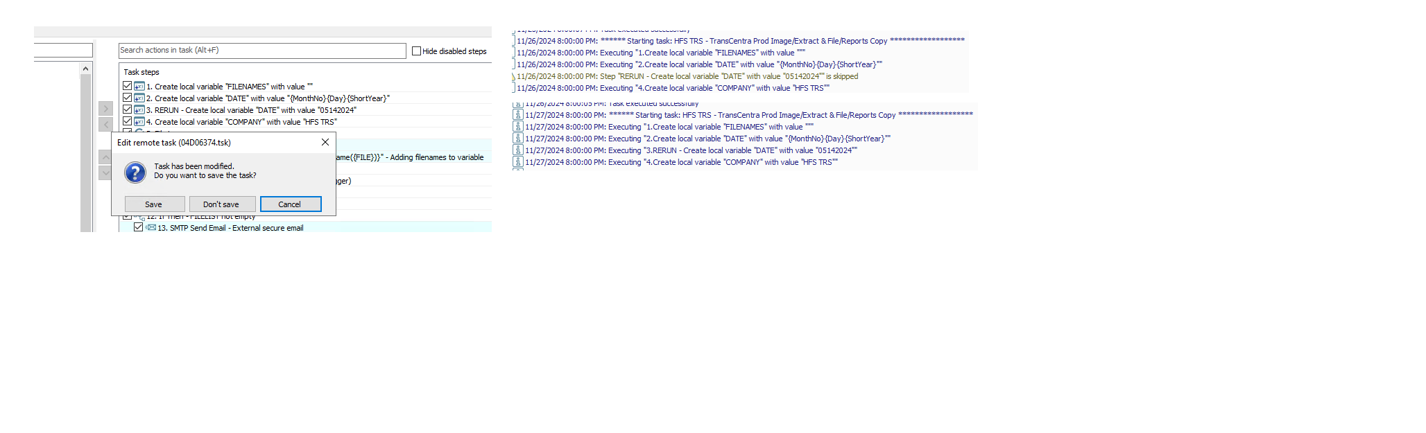

Are you aware of this bug happening? When I open a task to look at the steps, it will on a rare occasion enable a step that I had disabled on its own. I know you have no way of verifying that I didn't change anything when I opened the task, but all I did was open the task, look to see if a step was there, then I tried to close it. Then it wanted to save the changes, which consists of it enabling step 3.
I've included a screenshot. You can see on the 26th I had the step disabled as it always should be, its only used when we need to resend a previous day's files. Then on the 27th I did change a file path on a different step and save it. But I didn't notice it also checked step 3 on its own, so then it caused issues going to the wrong day.
I don't believe we had this issue with 9.4 to the best of my knowledge. I believe it started once we updated to 9.9 sometime around the end of February 2024.

I noticed the same problem since we switched from version 9 to version 10.
Sometimes a disabled action is re-enabled by the system, but I haven't noticed any regularity yet.

Post by Lana_K »
I also noticed the same. Only before reading this I kept blaming myself for accidentally clicking the box and ticking/unticking it. And I noticed both enabling and disabling of actions. I haven't noticed any regularities either, but for me it mostly happens within a loop - either a step within a loop gets enabled/disabled or the 'end' action. But this can be because I use loops a lot.
