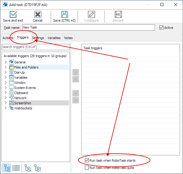

You should have two tasks:
1st is the main task. Attach a HotKey trigger to this task
2nd task - the task starts the main task with a delay. Algorithm is simple:
  • Pause - 5 minutes
  • Start Main task
Check this option (see screnshot)
So you achieve your goal:
  • the task starts by hot key
  • the task starts when RoboTask starts with delay
