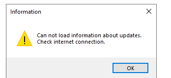

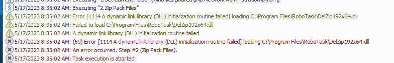

I have two more small questions.
We installed a new anti-virus and I believe it messed up zip packing files. I have attached the error message we are getting, it references the DelZip DLL . Yesterday when the error appeared we uninstalled Sentinel 1 from the server and after a reboot the zip feature was working, but today it's not working again and S1 was never re-installed. I am wondering if something residual stayed and has messed up with the DLL. Would you have that available to download?
The 2nd question would be for the check for updates. I have also attached the error, basically it says check your internet.
We have pretty strict rules on our firewall so I am sure it's being blocked. Do you have an IP address or URL that the check for updates tool is reaching out to so I could white-list that?
Thanks for all your help.
the updates URL is: https://www.robotask.com/rss/updates/
Of course CheckForUpdates utility uses this URL with parameters: product ID and current version
