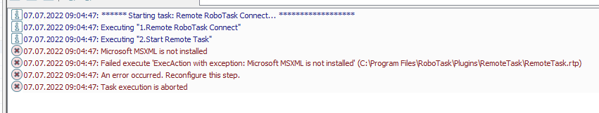

Ok, I did some more research and set up the user with special user rights to write into the folder in 'RoboTask Server Manager' => 'Network Server Parameters' => 'Edit internal list of users'.
Then I created a Task to create a text file in the folder.
Then I created another task and used 'Remote RoboTask Connect' and connected to the service.
The 'Test connection' returned 'Connection established'. So far it works.
But the next task 'Start Remote Task' gives me an error:
- Screenshot 2022-07-07 091711.png (22.77 KiB) Viewed 12309 times
I can not find this plugin in 'Settings' => 'Plug-ins'.
Is my setup correct or did I miss something?
Re: Write files to folder with different user rights
Posted: Thu Jul 07, 2022 10:17 am
Hm-m-m... This is a bug.
We'll investigate this and release a patch ASAP
Posted: Thu Jul 07, 2022 1:13 pm
But the next task 'Start Remote Task' gives me an error:...
Download and install fresh copy:
https://robotask.com/download/
This bug has already been fixed.
Posted: Fri Jul 08, 2022 11:48 am
by sarnusch
I installed the new version and the problem does not exist anymore.
