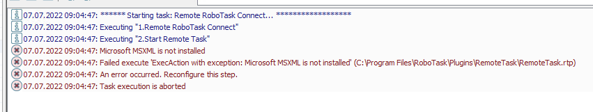

But the next task 'Start Remote Task' gives me an error:
Screenshot 2022-07-07 091711.png (22.77 KiB) Viewed 12390 times
I can not find this plugin in 'Settings' => 'Plug-ins'.
Is my setup correct or did I miss something?
Posts: 3309
Re: Write files to folder with different user rights
Hm-m-m... This is a bug.
We'll investigate this and release a patch ASAP
Posts: 3309
But the next task 'Start Remote Task' gives me an error:...
Download and install fresh copy: https://robotask.com/download/
This bug has already been fixed.
sarnusch
Posts: 69
Post by sarnusch »
I installed the new version and the problem does not exist anymore.
