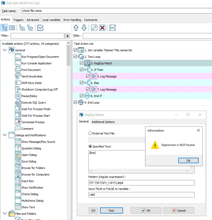

I am just getting this information after using the 'Test' button even if I use real data in the 'Specified Text' field:
Screenshot 2022-07-04 110509.png (109.63 KiB) Viewed 7249 times
Re: Check if variable is numeric
Posted: Mon Jul 04, 2022 10:31 am
the string {line} does not contain necessary expression
For testing put the name explicitly and press "Test"
At runtime RoboTask expands variable and put the name instead of {line}

Posted: Thu Jul 07, 2022 10:09 am
by sarnusch
Hello Oleg,
ok, It was my mistake because I misunderstood the error message.
It works now as expected.
