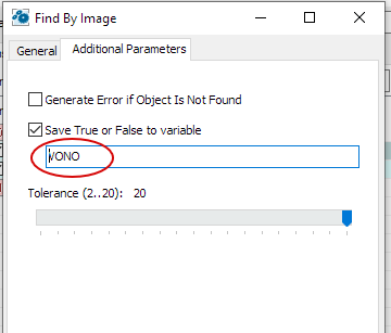

Re: Save True or False to variable (Find an Element by Image
You must specify variable name only (without braces)
see screenshot below:

Re: Save True or False to variable (Find an Element by Image)
safarpour_e wrote: ↑Mon May 16, 2022 4:44 pm Hi, I have a problem too
E: 5/16/2022 8:38:32 AM: Value "VONO" is not compatible with boolean expression
E: 5/16/2022 8:38:32 AM: An error occurred. Step #4 (If Then).
I want to see your task
VONO on previous screenshot is the variable name (not boolean value)
