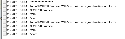

However, I see the variables in your script are separated by a space and not a comma or semicolon, or do I miss something?
Re: Multiple variables at once
Posted: Thu Sep 02, 2021 2:53 pm
...I see the variables in your script are separated by a space and not a comma or semicolon,...
Where? Maybe I don't understand you...
Explain in more details, please
Posted: Thu Sep 02, 2021 3:09 pm
by Rukbunker
It spits out the variables divided by a space, not a "," or a ";"
Posted: Thu Sep 02, 2021 4:04 pm
You gave me CSV text wit COMMA separated lines
The CSV looks like:
Customernumber,CustomerName,Mail
000001,Robotask,info@dummymail.hay
000052,YankyDoodle,dontwrite@mail.co.uk.br.tr
Also pay attention that strings with spaces or commas "," must be quoted in standard comma-separated string. Like this:
123456,"Customer with spaces",robotask@robotask.com
Look at new example below. I added Split text action to convert line to standard comma-separated line
Posted: Fri Sep 03, 2021 1:34 pm
by Rukbunker
That was the solution! Many thanks for your time !
