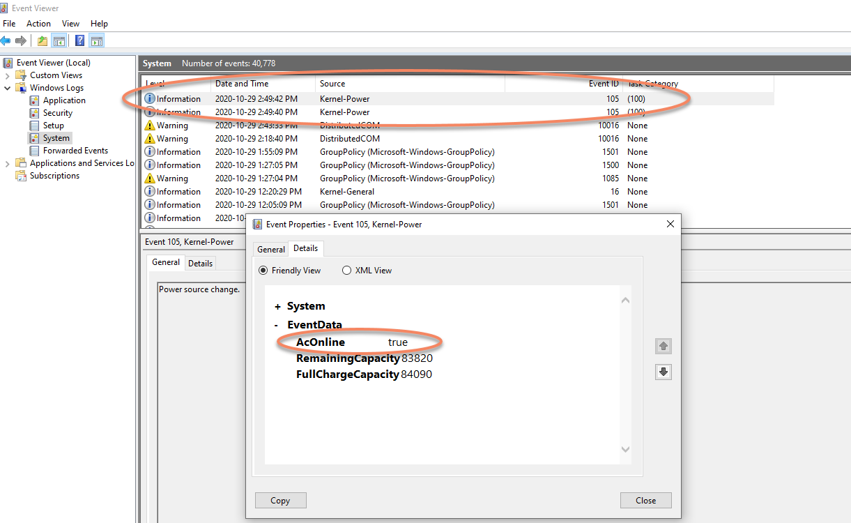

Hi there.
I would like my triggering event to be when my laptop which is on (not off/asleep/hibernated) detects that AC power is restored. This is logged as an EventViewer/System/Event 105. I have attatched a screencap here of the event. Can i create a custom trigger? or does one already exist? Is there another way?

Thank you for your response.
The problem with this approach is that some power fluctuations that we are trying to detect only last for a second, therefore checking every 10 seconds will likely miss it. That momentary power bump is an actionable for us as there is other equipment that require remediation after such events.
