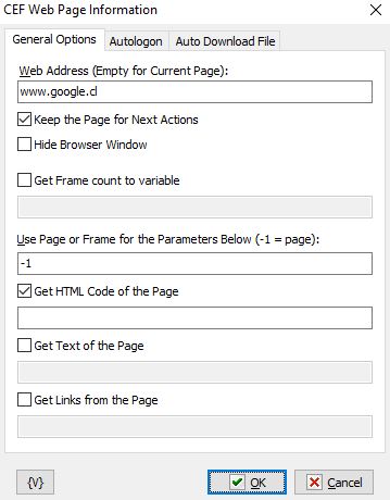

Hi team,
I'm trying to get the full HTML code from a website.
I used "CEF Web Page Information", add a web address, select "Get HTML Code of the Page", but I'dont know what to write in the "Space blank" under "Get HTML code".
I run the taksk, open de web page....but nothing is saving to any file.
Can you please helpme on this
(i'm running the 7.8.6.1009 x86 version)
Re: Get HTML Code
....but I'dont know what to write in the "Space blank" under "Get HTML code".
Type variable name where you want to save HTML code
Look at my example below.
CatID=INTEGER|1163085779
ExternalName=STRING|"Task1206"
ID=INTEGER|42149328
Name=STRING|"Get HTML code"
ActionID=STRING|"A_CEF_PAGEINFO"
Name=STRING|"CEF Web Page Information"
address=STRING|"www.google.cl"
autodownload=STRING|"0"
autologon=STRING|"0"
framecount=STRING|"0"
framevar=STRING|"-1"
gethtml=STRING|"1"
getlinks=STRING|"0"
gettext=STRING|"0"
geturl=STRING|"0"
hide=STRING|"0"
htmlvar=STRING|"MyVar"
keep=STRING|"1"
overwrite=STRING|"0"
password=STRING|"UmA2zrXORlUJC4x3U8ItOsf+G1UdewLUHCWGeijJuytMwAdME3JM0D83MkCVD5ZJfAxNMPzBUJQ="
referrer=STRING|"1"
Name=STRING|"Create text file {TempDir}\html.txt"
encode=STRING|"0"
fileexists=STRING|"0"
filname=STRING|"{TempDir}\html.txt"
line0=STRING|"{MyVar}"
suppress=STRING|"0"
Name=STRING|"Run ""html.txt """
ifnonzero=STRING|"0"
program=STRING|"{TempDir}\html.txt"
runas=STRING|"0"
wait=STRING|"0"
