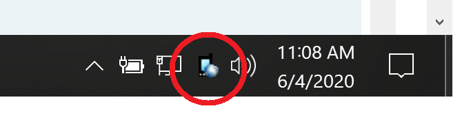

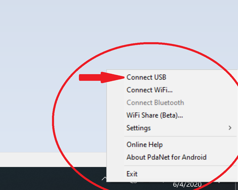

The software itself doesn't need to be monitored in order to trigger any reactions from your program. The internet connection is what needs to be monitored for disconnection. Once the program detects that the internet connection has been severed, I need this program to click on the PDANet icon on the SYSTRAY to pull up the menu. I've attached screenshots of the icon and the menu with the option to be selected in the event of internet disconnection.
Connect USB.png (99.26 KiB) Viewed 44355 times
I hope I've given enough information and the screenshots help. Please let me know if there's any other info I can provide in order to help everyone understand more what I'm hoping to accomplish. Thank you

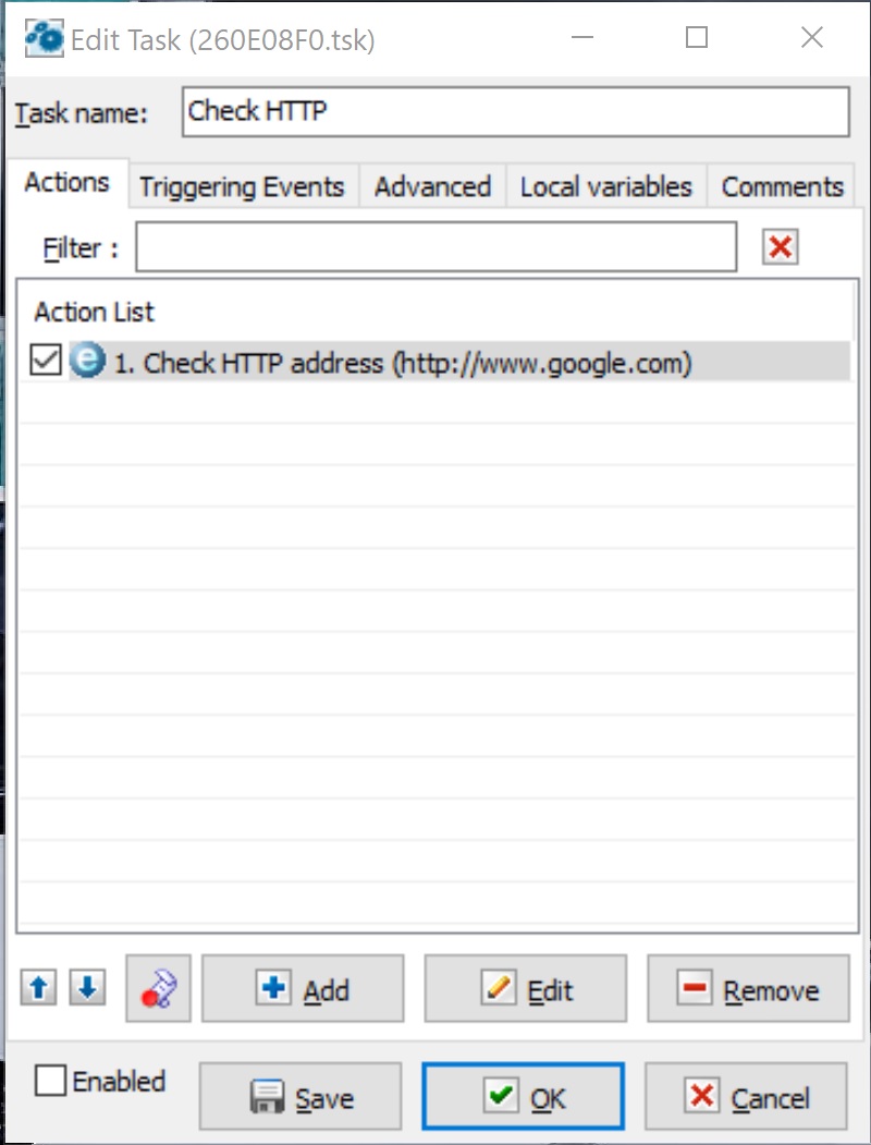

you can ping some web server. For example the Web server of your provider or GOOGLE.com
If you get invalid reply time the maybe the connection doesn't work.
If Ping service is disabled on server (in most cases) you can use Check HTTP address action to check the response of HTTP server
You will get an error if connection is lost.
read here how to handle errors: https://robotask.com/help/index.php?err ... essing.htm

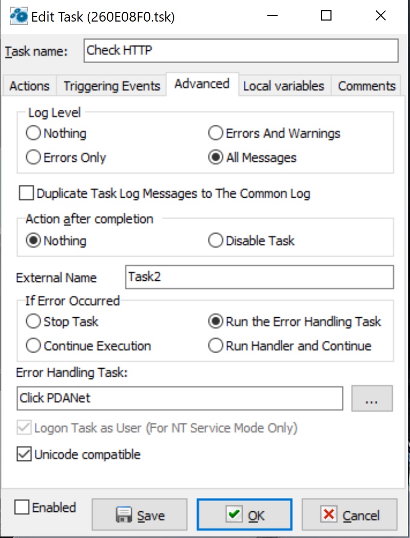

You can check the connection for example every 30 sec (look at the Cyclic trigger). If the task determine the disconnection run the task to re-connect.

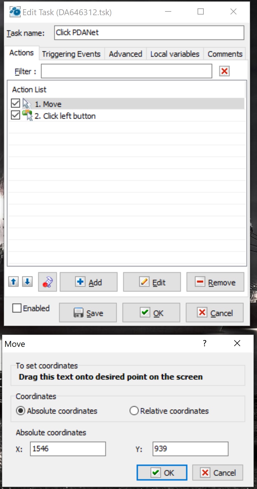

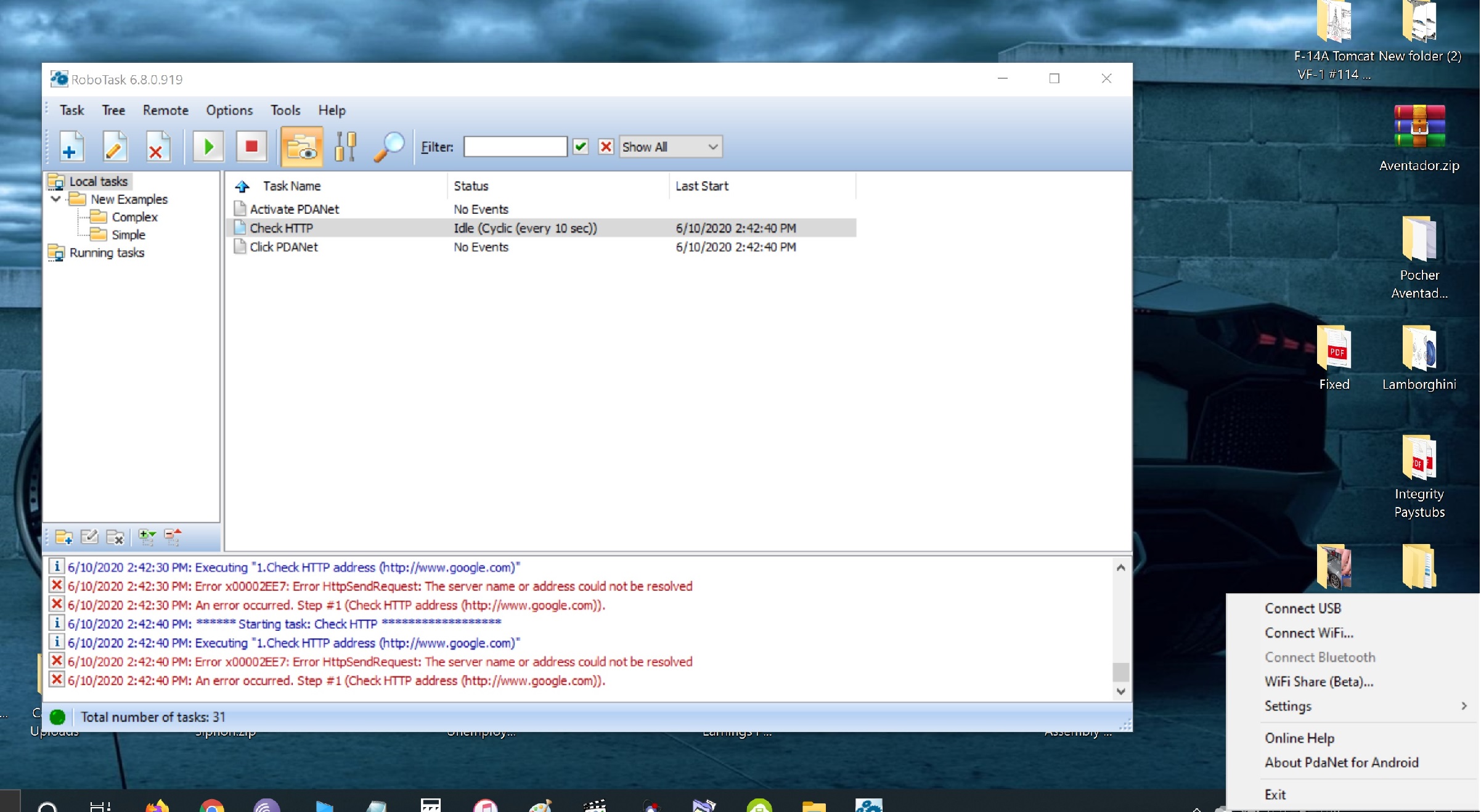

Ok, I've figured out almost all of it except the last couple of steps. So I have the software check http://www.google.com and if it returns an error, it triggers the "Click PDANet" task which goes to the specific location on the Systray and left clicks on the icon. The trouble I'm having left is after the menu pops up like that in the attached screenshot, getting the mouse to then move up the menu and to click "Connect USB". I've tried adding another move and click command in the "Click PDANet" task but the menu doesn't pull up at the location like in the attached screenshot. It opens up somewhere else on the screen thus nullifying the 2nd set of commands to move to a specific location and clicking on "Connect USB". So I removed those 2 extra commands and it works fine up to that point.
How do I get it to finish the last 2 steps which is to move the mouse up the menu after the icon is clicked and then left mouse click on "Connect USB"? I've tried adding another task as you can see under "Activate PDANet" which basically goes to the specific spot on the screen and then is supposed to click the selection "Connect USB" but it doesn't work. The menu just stays open and the program just repeats the cycle of checking the website and then on error completing the "Click PDANet" task. The cyclic cycle to check is every 10 seconds.
Hopefully I haven't confused anyone with what I said. It's always easier to see it for yourself rather than have it explained via words.

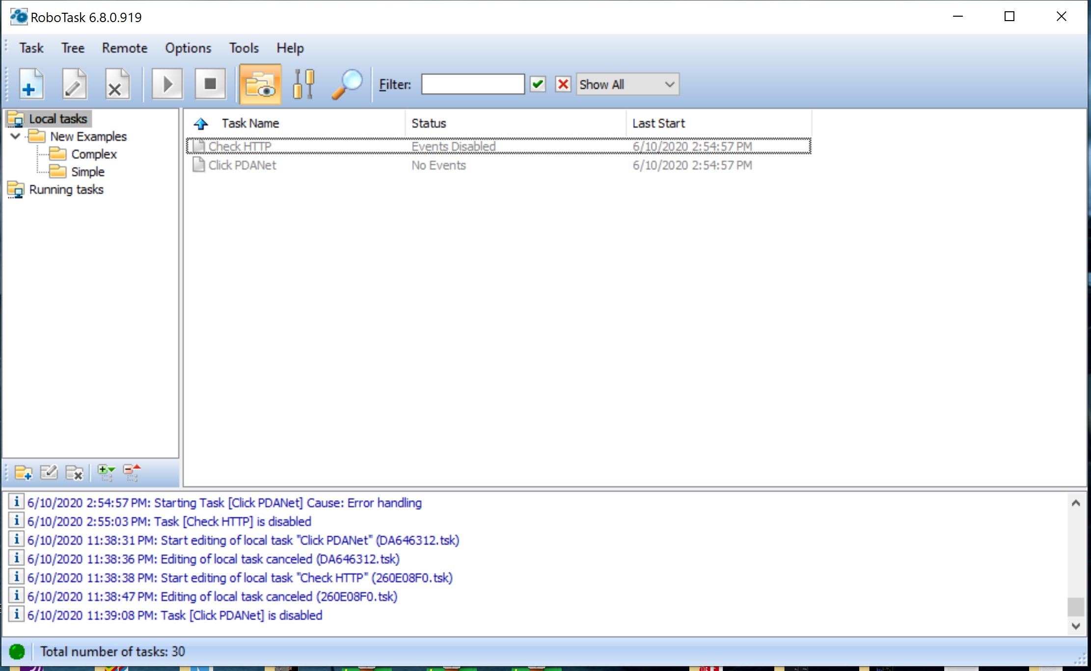

I've attached screenshots of the program and the tasks and their settings for you to see so far it looks good and I just need it to do 2 more steps which I can't get to work. The next step I need is for the mouse to move up the menu after the icon in the Systray is clicked and then select "Connect USB".
Hopefully these will help you see what I've done so far and hope it's correct.
Can only attach 3 files, need to add another response for the last attachment.
xyberz
Posts: 7
Joined: Mon Jun 01, 2020 5:54 am
Re: Reactivation of tethering software on disconnect
Post by xyberz »
Here's the last pic. As you can see for the "Click PDANet" task, it only has 2 functions which is to move the mouse specifically to the icon on the the Systray and then to left mouse click it. I have tried to add another "move mouse" and then "left click mouse" action but the menu that pops up shows on some other part of the screen instead of down by the Systray where it normally does without those 2 extra functions. So I took them off and then it works perfect up to that point.
