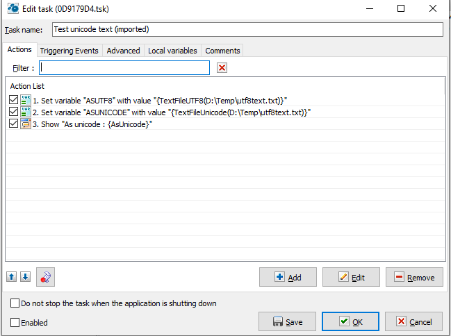

Thanks for your response. I don't what I am doing wrong. When I save your example and import, I do not see the complete task imported. I will upload a screenshot of what I see.

I see now that what I imported is what is intended. I was thrown off by the other lines in the code window.
