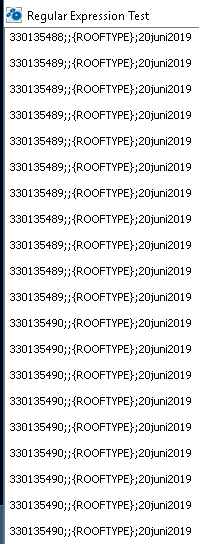

The output is working, but....not completely. Although Multi-line is selected, he only seems to "convert" 2 lines and does that mutiple times. I assume it's a very simple solution.

Re: RegEx: add text after every line
Posted: Thu Jun 20, 2019 10:56 am
Look at my example

If you are not familiar with regular expressions you can modify this text in the loop without usage of regular expressions.
Also please note that variable ROOFTYPE is undefined in your task
