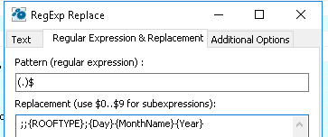

I use the expression:
Expression
Expression

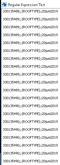

The output is working, but....not completely. Although Multi-line is selected, he only seems to "convert" 2 lines and does that mutiple times. I assume it's a very simple solution.
Result
Result
I searched the tutorial for a solution, but I wasn't able to find any that works. And by the way: my RegEx skills are not that high.
