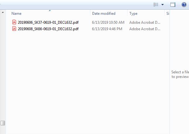

First, what I want to do is:
I need to upload the pdf file existed in specific folder to ERP system ONE BY ONE.
The file name already contains the information I needed to input ERP system, which is
Date_ReportNo_ProjectNo.pdf
So I need to :
1. Run the autotask when the specific folder has a new pdf file
2. Scan the 1st pdf file and get its file name.
3. Divided the name into 3 variables, which are, {Date},{ReportNo},{ProjectNo}
4. Open the webpage and login ERP system, type the 3 variables in specific field and upload the pdf file step by step.
5. Move the uploaded PDF from A folder to B folder.
6. Repeat the task if there is another PDF file after Step 5. Otherwise, end until a new PDF exist.
Any suggestions to do step 2,3,4?
Those always required the source location, but I am not using the fixed file, the PDF will keep changing.
How can I setup "select the 1st file in the folder"?

Oleg wrote:
anything I wrong?
Unfortunately everything
Use the expression to format date from foremat yyyymmdd to your format (mm-dd-yyyy):
{DateTimeToFormat({FormatToDateTime({expr(1)},yyyymmdd)},mm-dd-yyyy)}
Also look at my corrected example
CatID=INTEGER|1040932817
ExternalName=STRING|"Task565"
ID=INTEGER|-1724333428
Name=STRING|"Parse file name"
Action10=FOLDER
Action11=FOLDER
Action12=FOLDER
Action13=FOLDER
Action14=FOLDER
Name=STRING|"Set variable ""PDFFOLDER"" with value ""D:\incoming\pdf"""
varname=STRING|"PDFFOLDER"
varvalue=STRING|"D:\incoming\pdf"
[Actions\Action10]
Name=STRING|"Show ""file name: {filename}"""
[Actions\Action10\Params]
msg0=STRING|"file name: {filename}"
msg2=STRING|"unformatted date: {dt}"
msg3=STRING|"formatted date: {dt1}"
msg4=STRING|"Report No: {ReportNo}"
msg5=STRING|"Project No: {ProjectNo}"
msgcount=STRING|"6"
[Actions\Action11]
ActionID=STRING|"A_FLOW_ELSE"
Name=STRING|"Else"
[Actions\Action12]
Name=STRING|"Show ""The name {fileName} does not match!"""
[Actions\Action12\Params]
icon=STRING|"3"
msg0=STRING|"The name {fileName} does not match!"
[Actions\Action13]
[Actions\Action14]
ActionID=STRING|"A_LOOP_FILE"
Name=STRING|"File Loop"
createmode=STRING|"1"
date1=STRING|"20190617"
date2=STRING|"20190617"
destvar=STRING|"FILENAME"
DuringMinutes=STRING|"1"
file0=STRING|"{PDFFolder}\*.pdf"
filecount=STRING|"1"
savesize=STRING|"0"
searchkind=STRING|"0"
sort=STRING|"0"
sortby=STRING|"0"
sortorder=STRING|"0"
subdirs=STRING|"0"
timesize=STRING|"0"
WithoutPath=STRING|"0"
ActionID=STRING|"A_REGEXP_MATCH"
Name=STRING|"RegExp Match"
anchored=STRING|"0"
extended=STRING|"0"
line00000000=STRING|"{FileName}"
multiline=STRING|"0"
noautocapture=STRING|"0"
pattern=STRING|"(?i)(\d+)_([^_]+)_([^\.]+)\.pdf"
savesubexpression=STRING|"1"
singleline=STRING|"0"
subexpressionpos=STRING|"0"
subexpressionvar=STRING|"expr"
ungreedy=STRING|"0"
useexternal=STRING|"0"
variable=STRING|"match"
connection=STRING|"0"
count=STRING|"1"
operator=STRING|"0"
type=STRING|"3"
value1=STRING|"{match}"
Enabled=INTEGER|0
Name=STRING|"Show ""{expr}"""
msg0=STRING|"{expr}"
Name=STRING|"Set variable ""DT"" with value ""{expr(1)}"""
varname=STRING|"DT"
varvalue=STRING|"{expr(1)}"
Name=STRING|"Set variable ""DT1"" with value ""{DateTimeToFormat({FormatToDateTime({expr(1)},yyyymmdd)},mm-dd-yyyy)}"""
varname=STRING|"DT1"
varvalue=STRING|"{DateTimeToFormat({FormatToDateTime({expr(1)},yyyymmdd)},mm-dd-yyyy)}"
Name=STRING|"Set variable ""REPORTNO"" with value ""{expr(2)}"""
[Actions\Action8\Params]
varname=STRING|"REPORTNO"
varvalue=STRING|"{expr(2)}"
Name=STRING|"Set variable ""PROJECTNO"" with value ""{expr(3)}"""
[Actions\Action9\Params]
varname=STRING|"PROJECTNO"
varvalue=STRING|"{expr(3)}"
