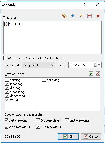

Example 1 (Picture 1 and 2)
Scheduler is set to 15:00:00. After pressing "OK", the old time is still displayed. Even after closing the task. Removing the scheduler as a trigger and add it again resolves the issue. But, I didn't had it before.

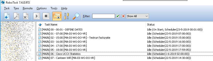

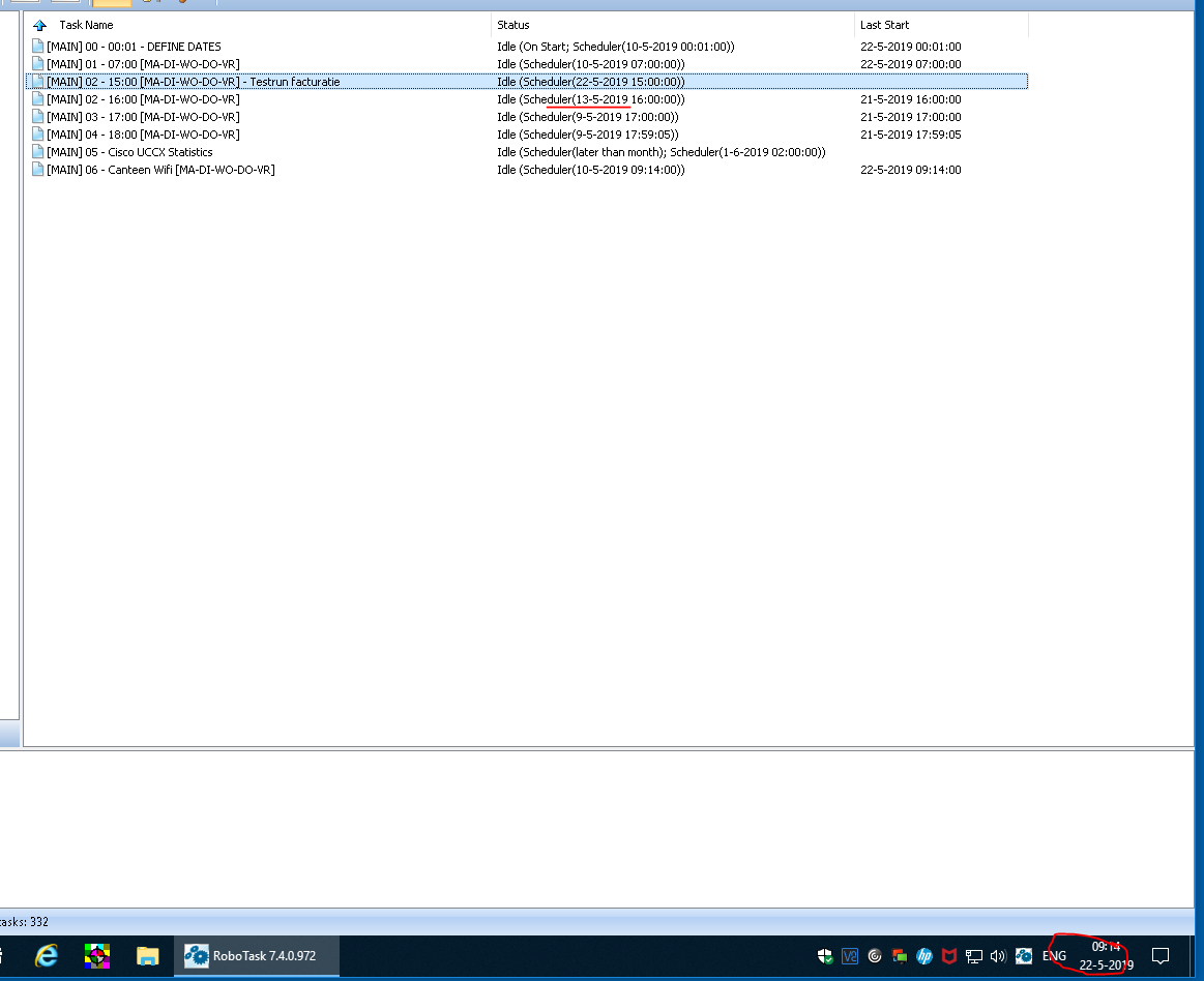

Example 2
Also, the "next run" time/date was normally displayed at the status column. Since the last update of the program this hasn't been refreshed. In the screenshot below a daily task is highlighted and "22-5-2019 16:00:00" should be displayed here.

Re: Time triggering event not updating
But that is exactly what is going wrong: I did not change the names of the triggers. I left it default.
When I reset it again to "default name", the status column is refreshed as it should be, ergo: next time of execution. But after execution, it doesn't refresh itself to next execution time.

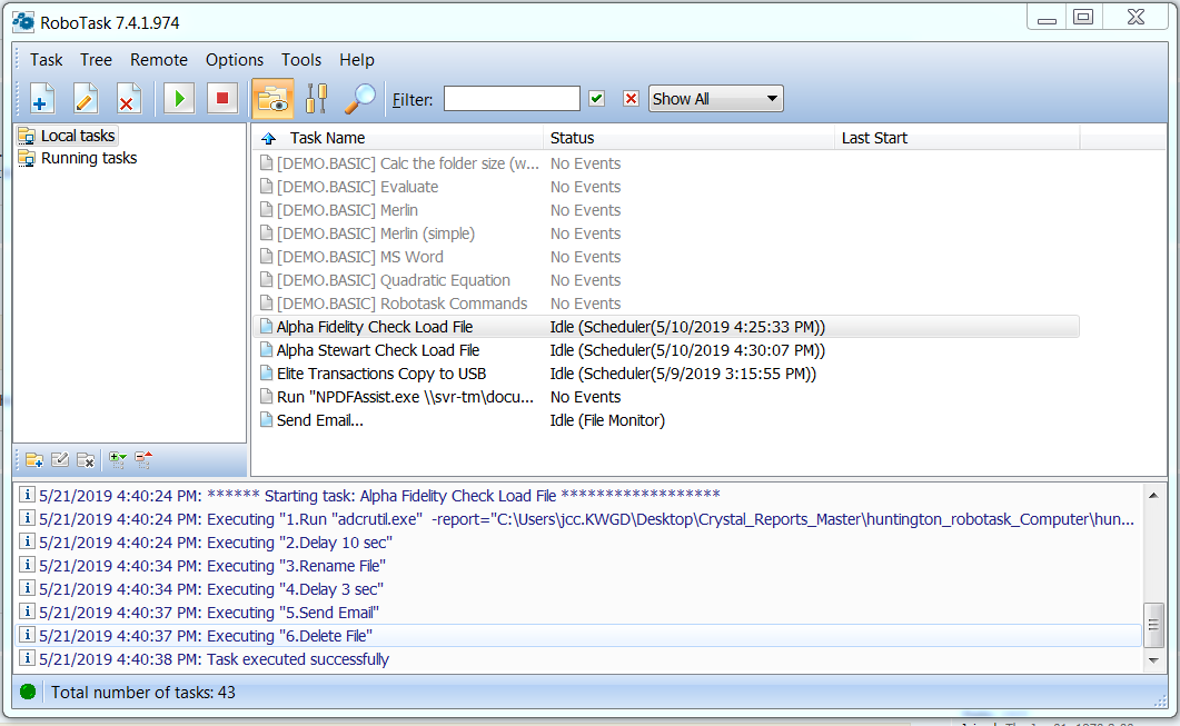

I have noticed the same behavior...I really miss the last start date not populating anymore. You need to look at the bottom of the task screen to discern when the task last ran and also be on the task itself. I like to scan through the "Last Start" information to quickly validate all tasks ran as scheduled. I have not updated my other PC that has 100's of tasks running for this reason. Can you restore the information in the "last state" column?
Last start time never saved. This is dynamic value in this session only.
But I wrote this into our ToDo. Maybe it's possible to do something.

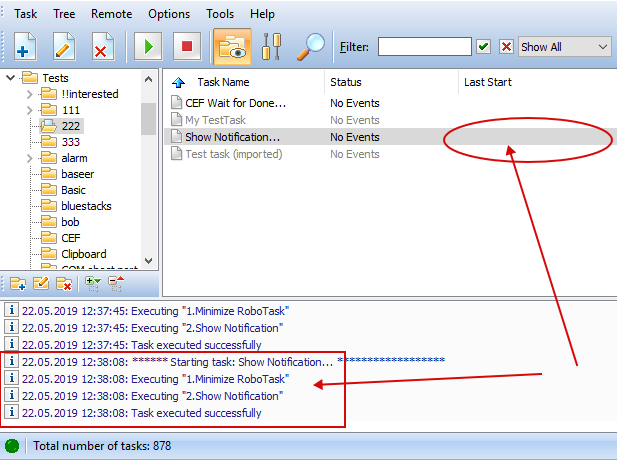

Advice
You can see last start of the task in the task log. See screenshot
