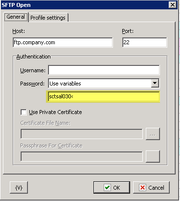

Hello;
I'm having an issue with a password of 10 characters to log in a SFTP site: last character of the password is changed to a weird character and, as result, RoboTask cannot log-in...
I have also attached an image.
Thanks
Immagine 49.png (6.14 KiB) Viewed 10291 times

Re: User Password for SFTP OPEN command
Post by Giupeppe »
Hello.
Change the last character of the password with 4.
Then press OK and save.
Then open again the SFTP OPEN command: the character 4 should be replaced by a symbol.
That's what happens in my environment.
I tried test example with password sctsal0304
It works. I also tried to restart RoboTask. It works correctly
Very strange... We'll try to investigate this, but I can't reproduce this...
What operating system do you use?
