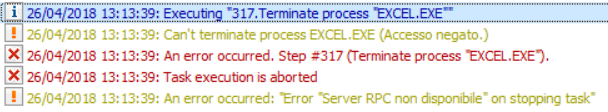

Hi, I created a new task but it stops when I try to end excel process.
Why the access to the process in denied?
Is there a way to bypass this problem?

I tried, it works without problems...
I: 02.05.2018 10:43:40: ****** Starting task: Terminate process "EXCEL.EXE"... ******************
I: 02.05.2018 10:43:40: Executing "1.Terminate process "EXCEL.EXE""
I: 02.05.2018 10:43:40: Task executed successfully
The task is
CatID=INTEGER|769107885
ExternalName=STRING|"Task46"
ID=INTEGER|2034567722
Name=STRING|"Terminate process ""EXCEL.EXE""..."
ActionID=STRING|"A_MISC_KILLAPP"
Name=STRING|"Terminate process ""EXCEL.EXE"""
more=STRING|"0"
process=STRING|"EXCEL.EXE"
