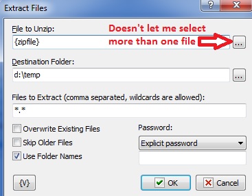

Here's the issue I'm running into. I'm not sure what to put in the text fields to get it to extract all the files instead of just the one I select (and I can only select one)
Like say I wanted to extract all the zip files in the folder C:/userfiles into the folder C:/outputfilse what would I fill in to make that work?

Re: Batch Unzip
The Extract Files action can unpack only one archive at a time.
So this button allows to select only one file.
If you need to unpack many files you have to do this in the loop: file-by-file
Import this task into RoboTask and change parameters to your own
look at my example above. It unpacks all ZIP files from the folder d:\zipfiles to folder d:\tempLike say I wanted to extract all the zip files in the folder C:/userfiles into the folder C:/outputfilse what would I fill in to make that work?
