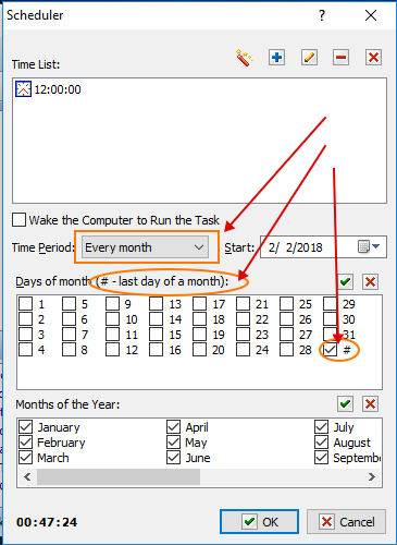

Does anyone have script or a way to have the scheduler kick off on a time at the last day of every month. I can schedule one a day each month but looking for something a little more specific. Thanks for all you help Trevor

Look at the Scheduler trigger
You can set it to last day of the month
Look at the screenshot
