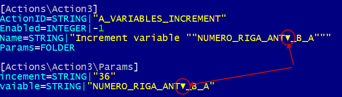

Look at the step #3.
Variable name contains the symbol with code 1F in its name. For some reason, I don't know why...
This symbol is non-printable, so you can't see it in the task editor.
Enter the correct name or copy it from 1-st step.
See my screenshots of text editor of your task. Also I saw it in HEX editor. The name of variable contains superfluous symbol

also see this in your post
