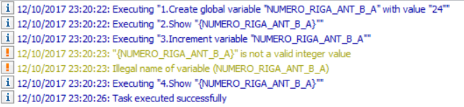

Hi, I want to increment the variable NUMERO_RIGA_ANT_B_A.
I use increment variable, without { } but i read that it's not an integer value.
I tried the same task in another PC and it works perfectly

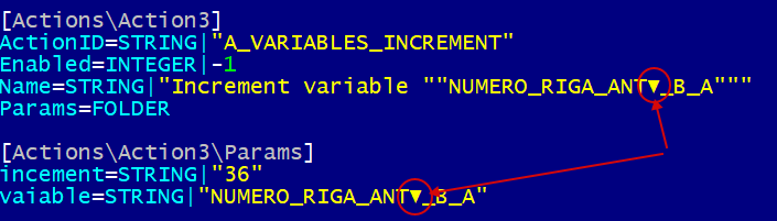

Re: Increment variable illegal name
Look at the step #3.
Variable name contains the symbol with code 1F in its name. For some reason, I don't know why...
This symbol is non-printable, so you can't see it in the task editor.
Enter the correct name or copy it from 1-st step.

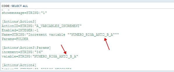

See my screenshots of text editor of your task. Also I saw it in HEX editor. The name of variable contains superfluous symbol
also see this in your post
