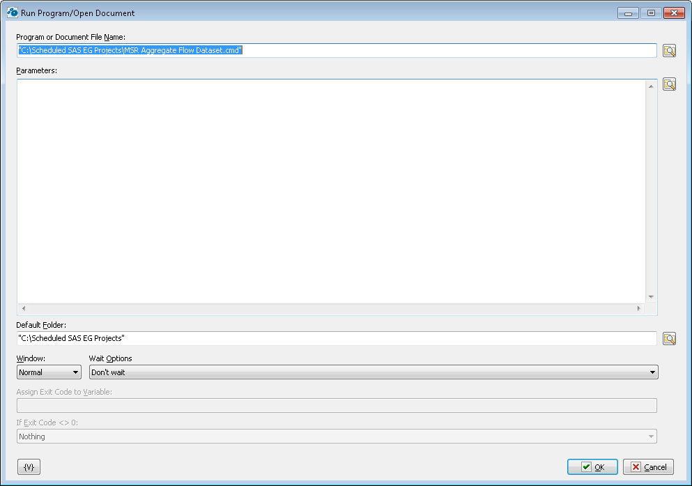

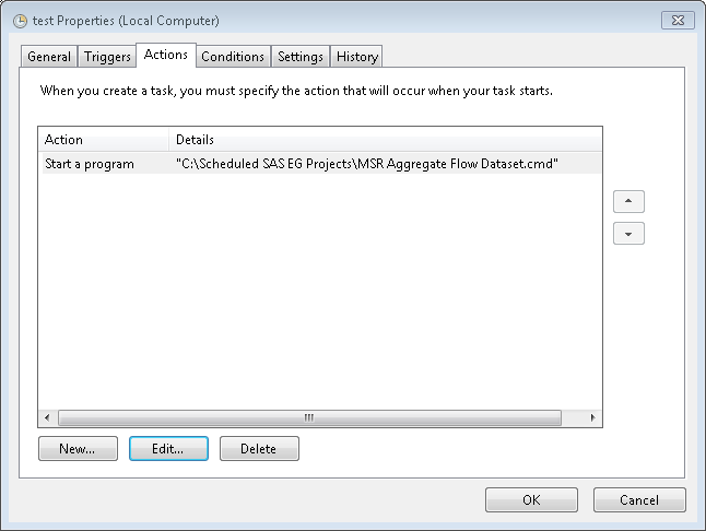

Hi, I am currently trying to run a .cmd file with a simply Run/Program task but it isn't working. The command windown just flashes and goes away. If I put a pause in the .cmd file, there is nothing there.... no errors or anything. The crazy thing is that I can call the same file with windows task scheduler and it works fine. Can you tell me why this isn't working?
I have attached screenshots of windows scheduler and robotask.

Windows Task Scheduler run the task under SYSTEM account
But when you try to run the CMD file from RoboTask application it starts the CMD file in your own user account

Oleg, yes.. that was what was so confusing. When I click from explorer it works fine. Same with Windows Scheduler. I just can't get it to work with RoboTask.

Hi Oleg, I am still having this issue. Like I mentioned, I am able to double click the file and run it just fine. I am not sure why using the user account over the system account matters. I do have admin privledges on my machine. Any other ideas?
