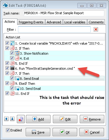

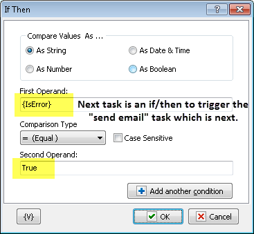

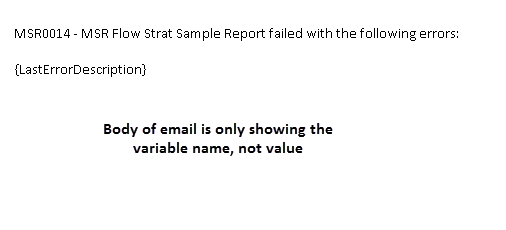

So the issue I am having now is the error description is not populating in my "Send Email" task when the task before it fails with an error. I am not sure what I am doing wrong. I have attached screenshots of my setup. The final 2 screenshots will be in a reply to this post.

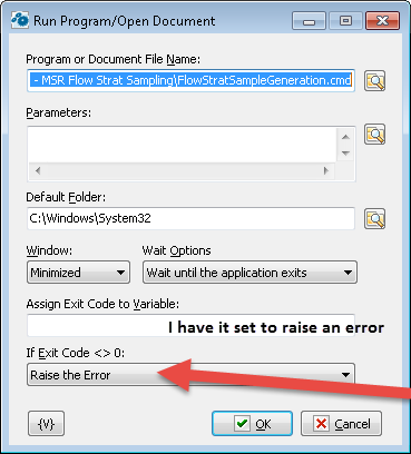

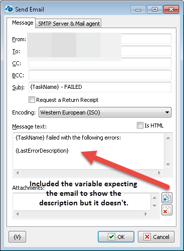

The remaining screenshots.

Re: Task status email notifications
I think that the task works without error and the step #10 sent this email.
You can check the task log to analyze the process.
The variable doesn't exist at normal work and you get the string {LastErrorDescription} instead of the error description

I am not sure I follow how to apply this to my task.
Step 6 in my task (the .cmd step) certainly fails. If I choose to show the error in the advanced tab, it pops up on the screen. What I can't figure out is why that error won't carry over into steps 7 & 8 so that step 8 email will send the error description. It can't be skipping to step 10 email because I don't include the variable in the body of that email.
