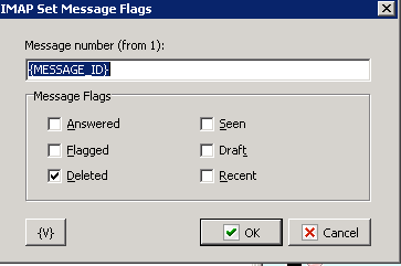

i want to use the function to delete an email from the inbox on an exchange-server via IMAP after parsing it.
Unfortunately, I get the error: A0010 BAD Command Argument Error. 11 An error occured: Reconfigure this step.

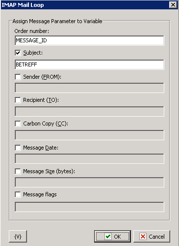

Here is the Order Number attachted to MESSAGE_ID
An here i take the MESSAGE_ID so set die Deleted Flag.
After execution i get the error above.
Can somebody help me?

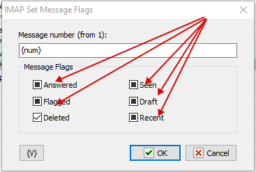

Re: IMAP Set Message Flags
Pay attention that all checkboxes have 3 statuses:
- ON
- OFF
- UNCHANGED
Maybe you need to keep other attributes unchanged
see screenshot
Post by Volumeman »
Thnak you very much...
this was the problem...!
