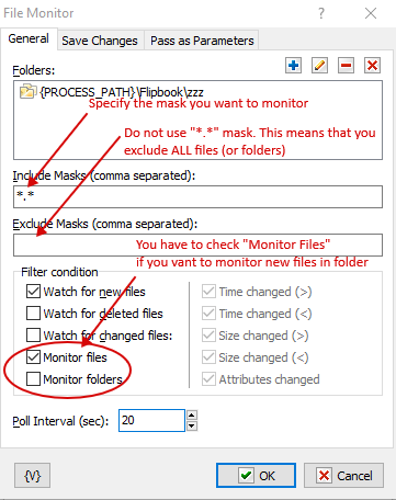

Your configuration will not work
Look at my example (see screenshot)
If you want to monitor files you have to check Monitor files option
If you want to monitor folders you have to check Monitor folders option
Do not use *.* as exclude mask. In this case you exclude all files or folders
Pay attention that zzz is not a mask. This is complete file or folder name.
