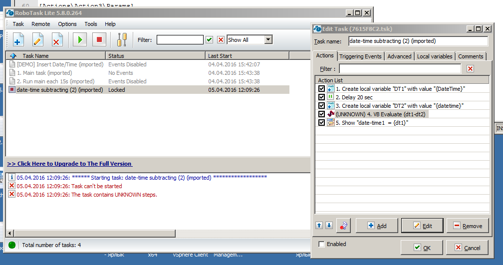

что не так делаю?
Re: Подсчет времени запуска программы
You have to upgrade software up to 6.3 (at least) of full version of RoboTask.
RoboTask lite doesn't contain loops and flows actions (Loops, if..then, else etc)
Also it doesn't support any scripting (VB script and Javascript)
