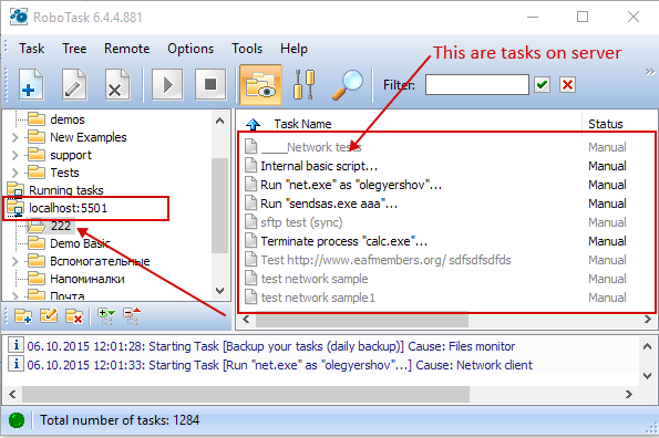

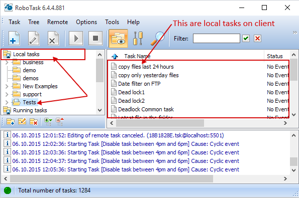

RoboTask will not run new tasks that we are adding to the server from a client. We have added tasks to the server and they will not run (they are enabled). New tasks that have been added from a client PC will not show up when viewed on the server, but will show in the client side version and we have verified that we are connected to the server, authenticated and are using the correct port.
Re: New RoboTask Jobs not Running
Are you sure that you really added tasks onto your server?
Look at the screenshots below
server tasks.png (50.9 KiB) Viewed 14812 times
local tasks.png (51.36 KiB) Viewed 14812 times

I simply forgot to connect to to the server at "local host:". My mistake. There were some other issues that were script specific and had nothing to do with RoboTask.
