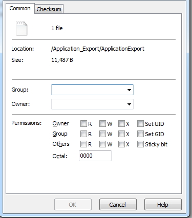

The files don't seem to have any permissions on the "Not Working" site nor do they have any Group or Owner details. I can upload files and Download Single files and i can use PSFTP manually to login and run the "ls" command to read the directory fine.
Not Working Site...

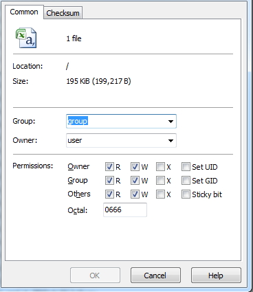

Working Site...

I'm afraid that you can do nothing if permissions are equals to 0000
BTW: sFTP actions work through PSFTP utility.

If you have no permissions to read you can't synchronize folders

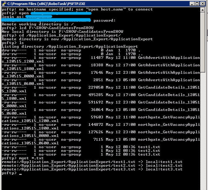

But I can Synchronize or list the directory contents from the PSFTP command line fine.
Could you please show me the command line and PSFTP scenario?

These are the commands I have used in PSTFP manually...
Sorry I said Synchronizing... in my original post but that's not what I'm doing or what i need to do I just need to Move the files from the remote sFTP server to our Local Server.

Of course you can use sFTP Command action with command: mget *.txt
See example below:
