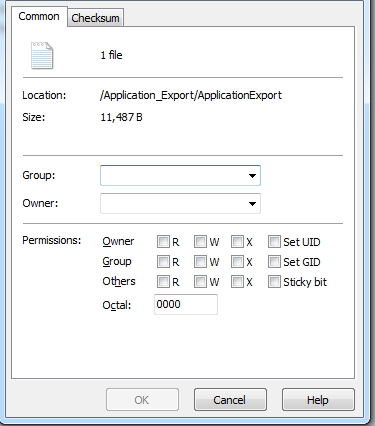

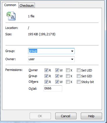

I am having problems when trying to Synchronize or use an sFTP File Loop to download a list of file from an external suppliers sFTP site...
I have this working for another suppliers site... Do i need to request special permissions on the "Not Working" suppliers site.
The files don't seem to have any permissions on the "Not Working" site nor do they have any Group or Owner details. I can upload files and Download Single files and i can use PSFTP manually to login and run the "ls" command to read the directory fine.

I'm afraid that you can do nothing if permissions are equals to 0000

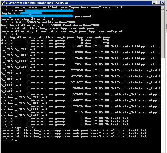

Strangely I can open the Directory and I can add files up onto the sFTP site or download individual files... I only have a problem if i try to Synchronize Local <= Remote or if i try to use the sFTP File Loop function.
But I can Synchronize or list the directory contents from the PSFTP command line fine.
Could you please show me the command line and PSFTP scenario?

These are the commands I have used in PSTFP manually...
Sorry I said Synchronizing... in my original post but that's not what I'm doing or what i need to do I just need to Move the files from the remote sFTP server to our Local Server.

Of course you can use sFTP Command action with command: mget *.txt
See example below:
