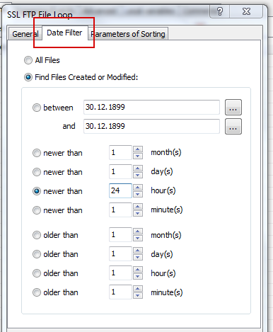

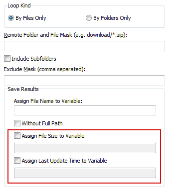

You can get file size and file date-time in FTP File loop (or SSL FTP File loop)
And a last upload date filter e.g. last 24 hours?
You can use filter in the FTP File Loop
