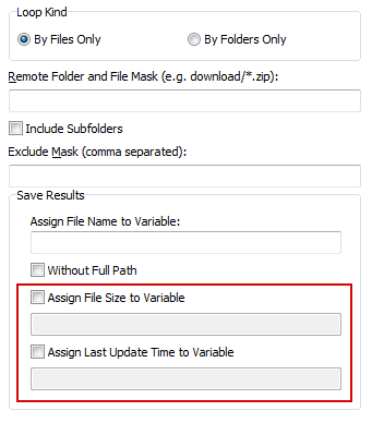

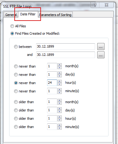

Is it possible to check if a file on FTP has a certain size? And a last upload date filter e.g. last 24 hours?

You can get file size and file date-time in FTP File loop (or SSL FTP File loop)
You can use filter in the FTP File Loop
