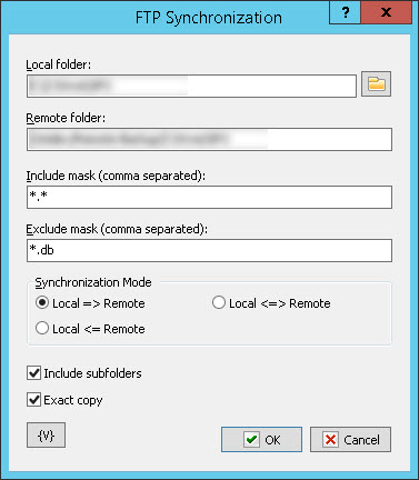

I have a simple script that does FTP Synchronization between one local server and a remote FTP site.
All non .exe files sync perfectly, but some random .exe files will not sync to the remote side.
The one .exe file that will not sync is only 21mb.
Local => Remote
Exact Copy is on.
The include mask is the default: *.*
The exclude mask is: *.db
Running Version 6.2.0.859

But I have .exe files on the local directory that are not in the remote directory. ...and nothing transfers to the remote.

I can use the FTP upload command to move the file, but Sync doesn't recognize a few of my .exe files.
