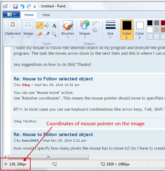

Re: Mouse to Follow selected object
You should determine this value empirically.
Also you can take a screenshot and calculate coordinates in the graphics editor.
PrtScr button to take a screenshot to system clipboard
Next open MSPaint utility and paste the image into it.
See screenshot:
