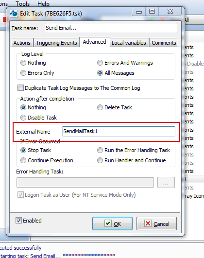

So you can make such error handling task
If {LastErrorTaskExternalName} = task1 then
	Send  message1
elseif {LastErrorTaskExternalName} = task2 then
	Send  message2
elseif {LastErrorTaskExternalName} = task3 then
	Send  message3
else
	Send  default message
end if
You can see and change external name of the task here (see screenshot below). External name the alternative identifier of the task. It is unique.

Using your example:
There are dozens of (main-)tasks, which each starts (sub-)task "Send Email..." sometimes.
If task "Send Email..." causes an error and an error handling task would be called, {LastErrorTaskExternalName} would report an error in task "SendMailTask1".
This info would be right but not very helpful as long as I don't know which one of my dozens of tasks started task "Send Email..." at this time.
It would be useful to pass an individual message via parameter to another (sub-)task, which would then automatically routed through to the error handling task in case of an error. Somethink like that.... ;)
