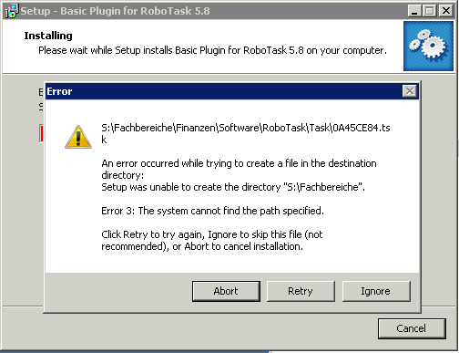

- Adding the BasicPlugin gave me a message, but it seems to work.
(the first file is an existing task, the second directory is already existing)

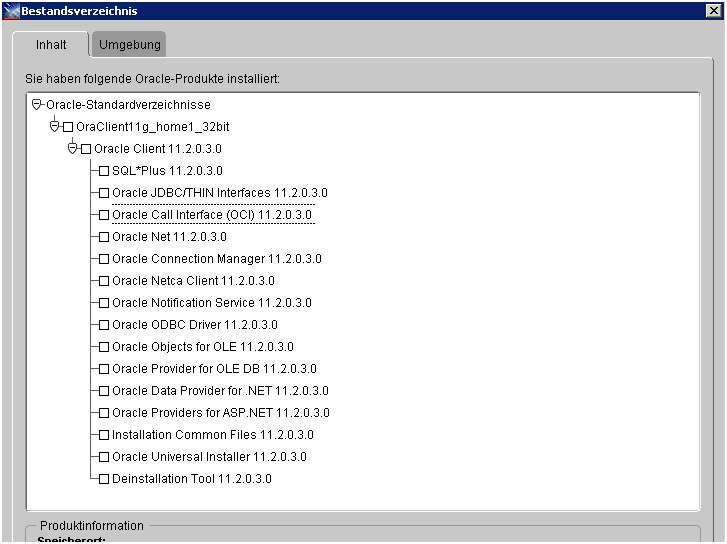

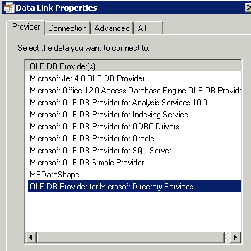

- "Oracle Provider for OLE DB" (32bit) is installed...
..., but I can't select it:

1. Check the permissions of the folder "s:\"
You try to place tasks in non-standard folder. Installer program places tasks in user profile folder by default.
2. Try the "OLE DB Provider for Oracle"
RoboTask uses ADO provider for any database. "OLE DB Provider for Oracle" uses native Oracle client software.

Oleg wrote:1. Check the permissions of the folder "s:\"
Permissions are: read, write, modify, execute
Oleg wrote:You try to place tasks in non-standard folder.
That's what I wanted. No good idea?
Oleg wrote:Installer program places tasks in user profile folder by default.
But the tasks are already in the other directory. I changed the path in the settings.
Oleg wrote:2. Try the "OLE DB Provider for Oracle"
That's exactly what I wanted to do. But how, if I can't select it? Maybe IT staff made a mistake during installation of Oracle Software... I'm waiting for their answer.

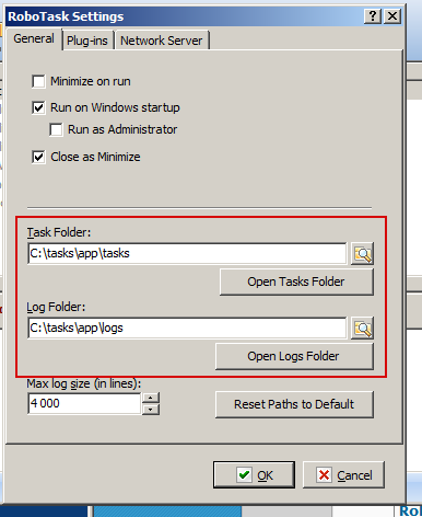

I have just tried to install RoboTask into custom folder on virtual machine (Windows 2008 R2 Server)
Also I defined custom folders for tasks and logs (see screenshot)
Next, I installed additional Basic plugin. Installation program has installed necessary files correctly without errors using new folders.
