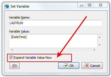

If you want to save variable value at this moment you should switch on parameter Expand Variable Value now
See on screenshot below:
Otherwise RoboTask calculates the value only when you use this variable.
See example below, which illustrates how this works:
