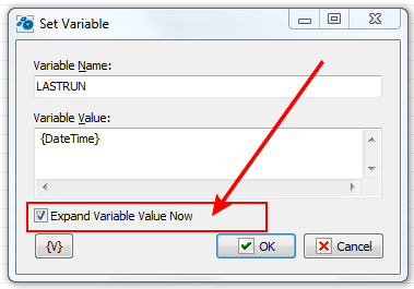

I'd like to assign a timestamp to a variable in case of an event.
I do that with Set Variable LASTRUN = {DateTime}
Later in the task I want to display this stored timestamp in the log windows.
I do that with Log Message "Last file activity: {LASTRUN}"
My problem is that the {DateTime} got stored but it always displays the actual time in the log window.
I am not able to read the variable LASTRUN with the timestamp originally assigned.
Is this a bug or am I wrong :?:
Re: function {DateTime}
If you want to save variable value at this moment you should switch on parameter Expand Variable Value now
See on screenshot below:
Otherwise RoboTask calculates the value only when you use this variable.
See example below, which illustrates how this works:
