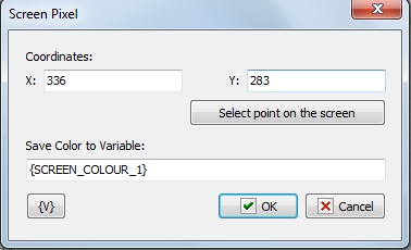

I am using the Screen Pixel option available in RoboTask 6.0, however it doesn't save the hecadecimal code into my variable. I created a variable called {SCREEN_COLOUR1}, and selected the coordinates I want to capture, but when I use the "Send text" function to write out my variable contents, it simply outputs the default value of 0, and not the hexadecimal code.
I have attached a screenshot of my Screen Pixel window. Please help.

UPDATE:
I realized that when I remove the { } from the variable's name, the task executes properly. Which is odd.
Re: Screen Pixel not working --- Help!
Yes, you should use variable name only (without braces)
You should use braces "{}" when you need to put variable value into the string.
Braces tells to RoboTask that it's necessary to replace this substring with value of variable.
