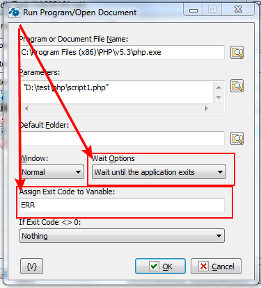

Like this:
Bez tytułu.png (12.93 KiB) Viewed 37996 times

There are two ways to achieve this.
1-st way.
Put into PHP script such code
die(<exit_code>);
-or-
exit(<exit_code>);
I use for my test simple script:
<?php
die(10);
i.e. my script generates the exit code 10.
You can catch and analyze this code in RoboTask (see screenshot)
See full task below:
CatID=INTEGER|317955339
ExternalName=STRING|"Task841"
ID=INTEGER|436396385
Name=STRING|"Run php and return code"
Name=STRING|"Create local variable ""ERR"" with value ""0"""
varkind=STRING|"1"
varname=STRING|"ERR"
varvalue=STRING|"0"
Name=STRING|"Run ""php.exe ""D:\test\php\script1.php"" """
ifnonzero=STRING|"0"
params=STRING|"""D:\test\php\script1.php"" "
program=STRING|"C:\Program Files (x86)\PHP\v5.3\php.exe"
runas=STRING|"0"
variable=STRING|"ERR"
wait=STRING|"2"
operator=STRING|"1"
type=STRING|"1"
value1=STRING|"{err}"
value2=STRING|"0"
Name=STRING|"Show ""Error: {err}"""
icon=STRING|"3"
msg0=STRING|"Error: {err}"
